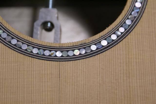

I have the exact same problem right now on one of my tops for an upcoming guitar. After I did the rosette I thought about throwing the top away b/c of the black stain. I routed on either side and added a b/w/b , but it did not cover the whole problem. Here are some pics. Any advice is welcome.

PostPosted: Tue Dec 05, 2006 2:02 pm
Posts: 412
Location: North Muskegon, MI
Homeboy,
My problem looks exactly like yours and also on the soundhole side.
I wasn't too happy about it initially but I did come to peace with it.
I don't like to say it's "good enough" as that is not how I work.
However, I know now the initial cause of the problem and what to do
differently next time.
To most folks I think it will be very subtle and easily overlooked,
especially if I don't point it out. To the trained luthier/craftsman's eyes it
will be apparent but so will many of the other "first-timer"
inconsistencies.
I found the more I tried to clean it up the more I was compounding the
problem. Therefore, I'm not calling it good enough, I'm calling a truce!
It's time for me and the top of this guitar to put aside our differences and
just get along.
Thanks alot guys for trying to help.
Christopher C. Cordle
